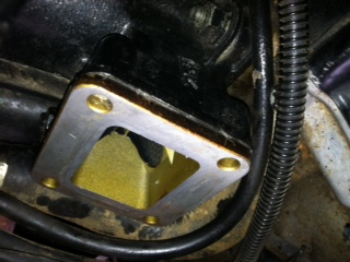

  1. The problem I'm having is I cant pull the reed cage out of the cylinder. Everything is unscrewed the intake is off and just the reed cage is sitting in the cylinder. The left side I managed to just pull out with some force. The right side wont come out no matter how hard I pull. Any tricks? What should i use to loosen the grip between the cage and the cylinder? Picture below.
