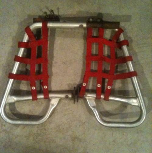

Does anyone know where to buy replacement netting for DG Nerf Bars. I contacted them but haven't heard back yet. I have the old style where the netting wraps aroung the bar and is then riveted. I have a rivet gun so it should be an easy fix, if I can find out where to buy them. Thanks
