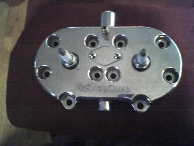

modquad head with 19cc domes and I believe all the o rings are there. used 2 rides great shape first 150 takes it shipping included. paid 210 for the head and 50 for the domes before shipping.paypal only thanks.
