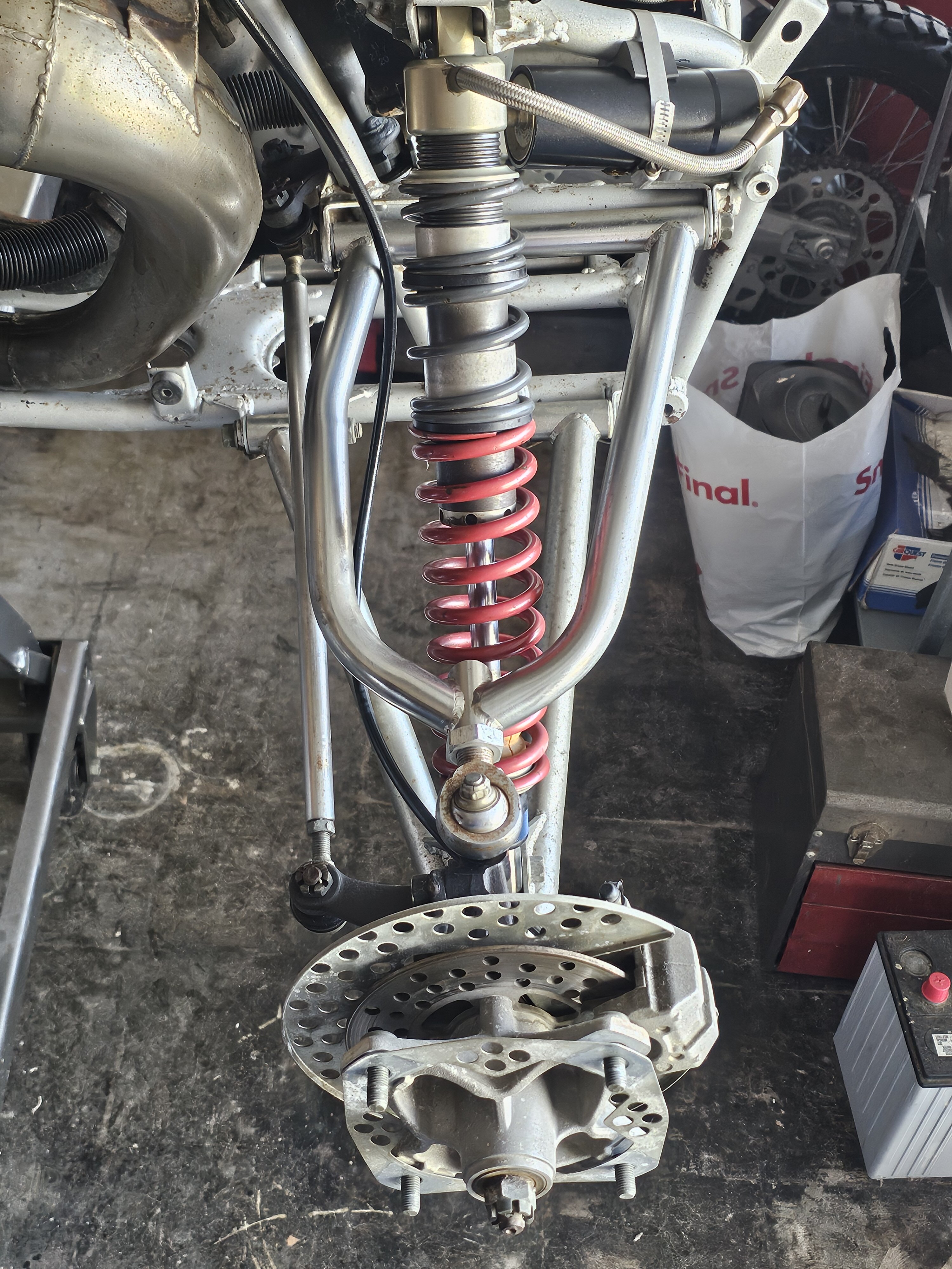

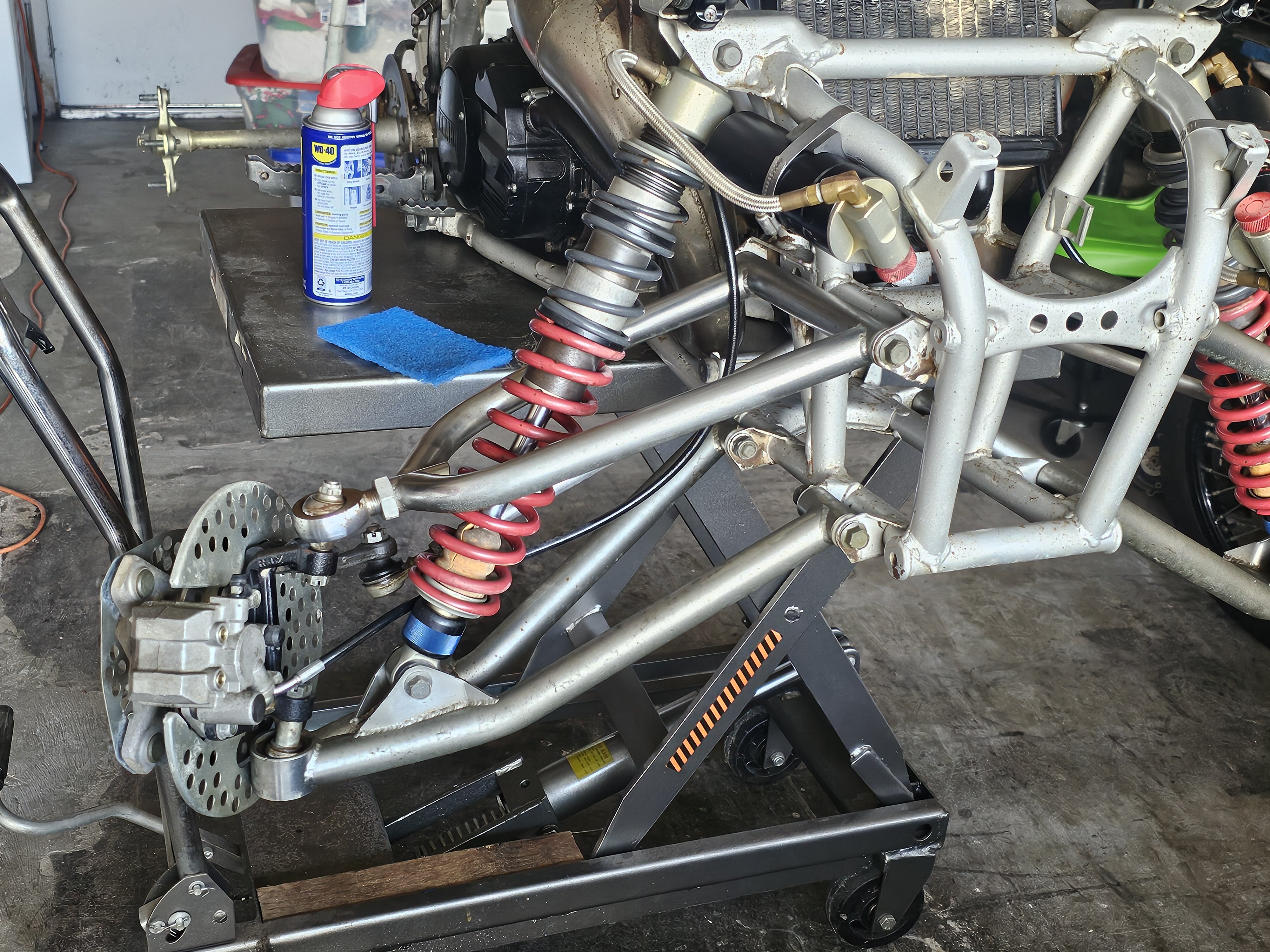

  9. Thanks for the input! Looking down at it, the top heim is definitely further back towards the rear, by more than a 1/4" - more like 1/2"-3/4"
  10. Do these arms look like they are installed correctly or should that top arm be flipped 180deg? Also what are some good things to measure and adjust while I have it up there and all apart?
