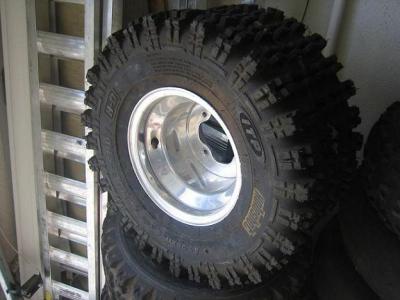

  4. Rims and tires for sale. See pic. Make offer. Also may consider trades.... looking for a set of sand tires.

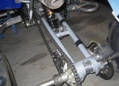

  5. I have a 6" over swingarm and want to change it out for a 2" over. see pics, let me know what you have....
