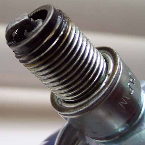

Okay so were riding in the field the bike was riding fine. Then I heard like tapping on metal and I dont think its the reeds because the spark plug gap was close shut on the right spark plug because I think it was hitting the piston Attached is a photo of the right side of the spark plug I searched the forums and did not see a topic on this
