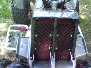

I have tried everything from a cut off wheel to a sawzall to a hacksaw.. The tool we found to work best was a jigsaw with "medium" tooth blade.. Clears out well but doesnt take out chunks.. We find our lines with masking tape using the inner edge as our cut line.. Helps to visualize a little bit.. After cutting them sanding them make them look perfect.. I did mine right before re-doing my plastics with that plastic renew kit wich worked out well cause I had to do some sanding anyway..
Right before wet sandin the paint..

you should see if cascade can do you an orange seat with that same stripe. Bike looks good.
Not a bad idea, havn't ever looked into that... Have to be gripper though-lol
After riding this thing with gripper seat I don't know that I could ever go without now..
Badass looking bike rippen!
Thanks for the compliments fellas!
