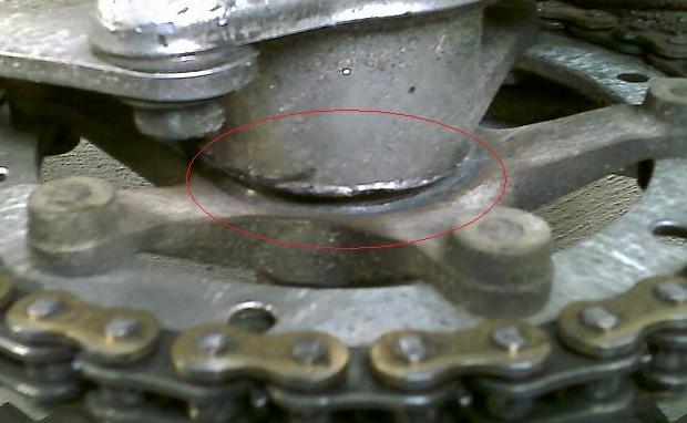

Hey guys,
A friend of mine has broken the rear case/hub? on the rear of the shee.
What do you think will need to be replaced and whats the correct name for that part?
I have an image attached of the break from the back, it happened in soft sand which is a bit strange?
Posted (edited)
Hey guys,
Its the swing arm axle bearing carrier. It does not look broken, looks like the bearings are worn and for that reason the sprocket hub ran against it. If you are lucky you will get away with only rear axle bearings and seals..
Edited by 2strokespirit
+1
