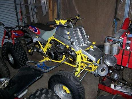

I finished the 4mil hill shooter. And after thousands i want to build a duner banshee now. I sold the YFZ450 and plan to build a nice duner.
My first goal is reliability. I have the 4mil that i get to work on and tinker with. I'm looking for suggestions from the guys who have built reliable bikes for the dunes. I say this becuase many a banshee are not reliable!
I'm thinking 370 long rod, Toomey pipes, V-force Reeds and intakes, possibly some pwk's. +2+1 arms and +2 axle, Not sure on the swinger length. At most +2.
I'd like to ad 3 lights 2 in the stock with flood and 1 handle bar spot. so a stator rewind is due.
Shoot me some ideas!
