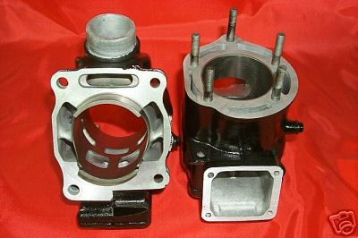

pasedogg Posted May 16, 2008 Author Report Posted May 16, 2008 heres some pics./ heres what he wroteabout my setup Ported for mid-to upper horsepower this is not a drag style porting that comes on like a light switch. This port job is excellent for Dune riding were you like a very strong midrange with lots of over hp to the upper RPM range. Stock carburetors work very well need to change the needle and increase the main jet to a 400 or 410. Other than that just hanging on. Thanks for the Inquirer discount cycle parts Quote
KEVSWS6 Posted May 16, 2008 Report Posted May 16, 2008 heres what he wroteabout my setup Ported for mid-to upper horsepower this is not a drag style porting that comes on like a light switch. This port job is excellent for Dune riding were you like a very strong midrange with lots of over hp to the upper RPM range. Stock carburetors work very well need to change the needle and increase the main jet to a 400 or 410. Other than that just hanging on. Thanks for the Inquirer discount cycle parts Looks good and clean. I think he meant a 310 main. I would try a 320. Like I said my drag ports never go over 350 mains on a stock carb. Quote
