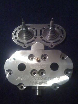

Got my noss head a couple days ago. Put that baby in today with 21cc domes and gained about 20-25 more psi. Its the best bang for your buck, defiantly. Looks good and adds hp. Also dave noss is the man!

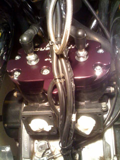

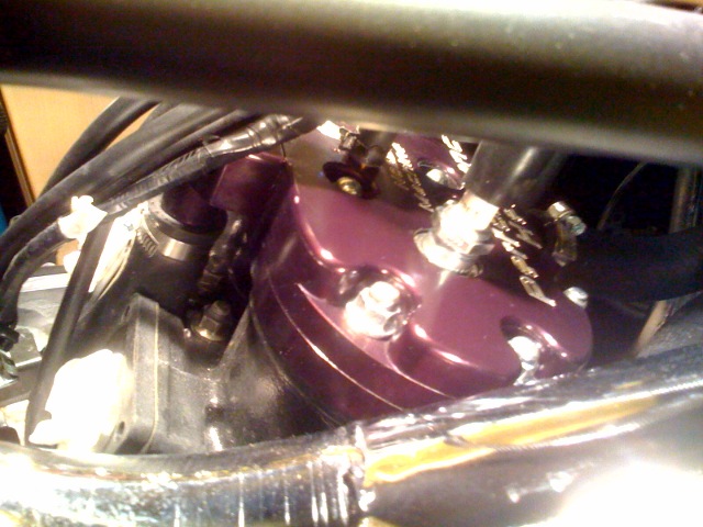

Does anyone have a purple...I mean "black" head? I have a black one but it looks purple. Oh well, other than that it's awesome! Nice fit, easy install, great compression, I definitely recommend them!
Link to comment
Share on other sites
Wow, that was black? How long ago did you get it? What do you wash it with? (Nothing should do that other than maybe an acid bath) I had to change anodizers a while back because the original one went out of business. PM me if you want to do something about it.
It might be cool if you wanted one that color.

So, I've been getting some PM's about the purple head. I guess it's a popular color. It's actually darker than the picture shows. It's a deep dark purple in the daytime.
Anyway, I replied to the PM's, but no replies so I'm gonna put it up for sale. One year old, great condition.
$150 plus shipping. Comes with nuts, new copper washers, new o-rings.
Also, putting in for sale forum.
thx!

No, it isn't normal. They are supposed to seal it in a hot nickel acetate (sp) solution (I think it's nickel acetate). If they don't seal it properly, the color changes.
-David
Link to comment
a black anodized head should be and stay black. this is if the head was anodized with no connection problems and for the right duration at the correct amperage as well as sealed at the right temperature. if the anodize layer is to thin you don't get deep enough penitration with the dye and black can appear to look purple or brownish.
