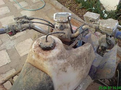

rubberneck Posted December 21, 2007 Report Share Posted December 21, 2007 As said, you want the temp sensor in the return line that way you are reading the hottest water temp in the system. I originally tapped into the power system at the plug that leads to the handlebar mounted switches. I pulled the pin out of the connector that is the power feed to the headlights and soldered a small wire to the pin that i then ran to the vapor. You also need to run one wire from the coil to the vapor to pick up the tachometer sensor. I had nothing but problems with the tachometer going crazy when i tried to use the shees electrical system, so i mounted a small hobby style battery where the stock tool kit would ride. Tach still isn't great, but I never use it anyway, cant look at it and ride IMHO. Mostly I like the odometer and the temp warning lights. Definitely use the magnetic bolt they supply, and you will need to either tweek the "C" bracket they send or drill your dust covers to accept the sensor.. As supplied, the "C" bracket will not line up with the bolt holes on the banshee spindle, but you can "massage" it into working. LOL oh yean, the handlbar mount they supply is shitty, mine broke from the vibration on the first trip out, never hit anything, it just cracked in 2. I am making an aluminum mount that will attach to my handlebar risers before my next ride. Hope this helps a little Quote Link to comment Share on other sites More sharing options...

rubberneck Posted December 21, 2007 Report Share Posted December 21, 2007 (edited) I guess you did change the pulse mode for the tach? Its not very accurate yes, especially on high rpms, mine is ok though. I made a aluminum bracket for mine. I had lots of troubles with my vapor, speedo cables is the 3rd one, I used it just for temp anyways. Yeah, all the settings are correct. i think my bike may have had a really noisy electrical system. I tried running resistor plugs, no effect. Tach just seems to suck. I tried hooking it up every way suggested, and shielding the signal wire. Just doesn't seem to work very well, but like I said, I really dont care. I just replaced the stator and regulator, and i have not tried hooking back up to the shees elec system. If I were to start over, I would probably just do a plain ol temp guage and be done. The odometer feature is neat, but i could live without it. I do like being able to monitor temps though and the programable idiot lights are a nice feature. I am going to make a bracket similar to yours, only one that will allow me to put 2 trail tech light up there also. Edited December 21, 2007 by rubberneck Quote Link to comment Share on other sites More sharing options...
