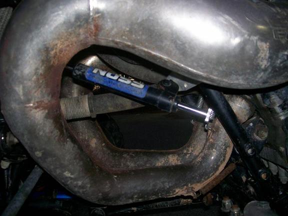

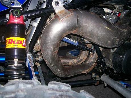

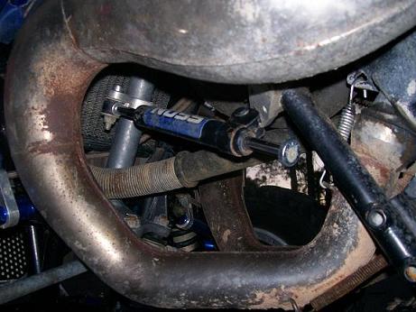

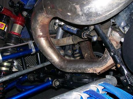

mine is connected to the bar on the left hand side as your sitting on the bike that the front motor mount is also bolted to, you can reach down and adjust it as your riding it works real nice, ill try and get some pics tommorow
