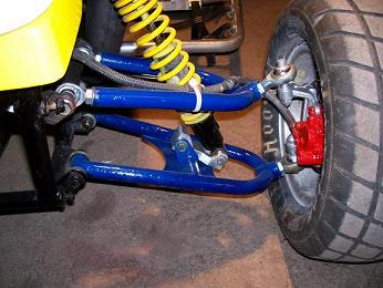

wiecha17 Posted November 6, 2007 Report Posted November 6, 2007 here are a couple picts of my shee w/ ASR +2 up 1 arms .wacko2000 Quote
wiecha17 Posted November 6, 2007 Report Posted November 6, 2007 (edited) left a arm ( rear) Edited November 6, 2007 by wiecha17 Quote
wacko2000 Posted November 6, 2007 Author Report Posted November 6, 2007 kool man thanks for the pics.. Quote
