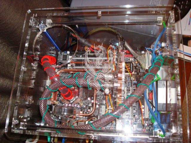

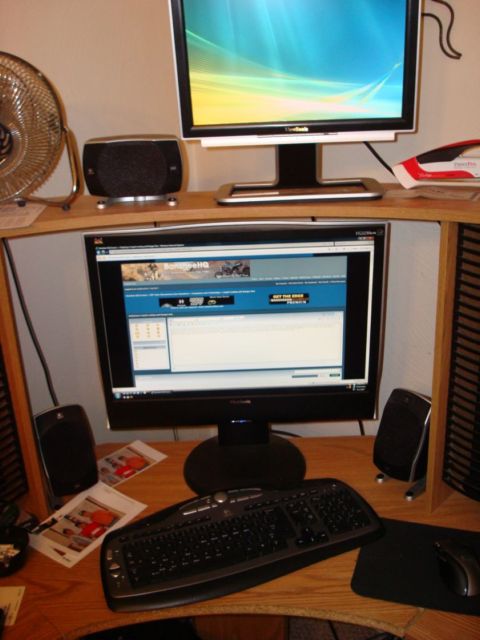

dogboystoy Posted September 13, 2007 Author Report Posted September 13, 2007 I know I have some things to work on with the routing and neatness of things inside, but it is so hard to hide something in a clear case. So I did the best I could at the time. Plus this project took a lot longer than expected, so I was anxious to get it back together and running. My Main monitor is a 22", and I like it just fine, I Cant see needing anything bigger. I dont write any code, so I dont see the need for a larger screen. I know/ Knew some DOS, but that system is mostly gone now anyway. I do like the laser etch that danger den did on my case they did ok, but they did screw up a couple of things on the case that I can tell you about later. Quote

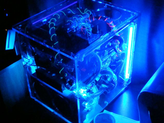

Justintoxicated Posted September 13, 2007 Report Posted September 13, 2007 (edited) Yes, it is hard to hind anything in a transparent case which is why I generly do not like to use them, that and I would probably scratch them up. Sure my desk looks clean now but wait a week lol. Be careful with those cathodes too, it seems like some of those converter boxes get hot and catch fire, which is why I do not like to use them anymore either, although I have not had a problem with them in the past. I'm really picky but I have been doing this stuff for some time now too! I would say you did a pretty good job hiding wires, most of mine are tucked behind the MB My Case is light with 2 Royal Blue LED's They are a deep purplish blue not like what you see in the pics looks much better in person. It was kind of a prototype but worked out extreamly well with my fan controller to dim them. They make anything Neo Glow jsut as well as a blacklight, but they will not make clear UV reactive stuff glow like you can with a blacklight. I was not expecting the results I got at all, it worked out better than it did on paper and I don't know why but it has to do with the fan controllers circuitry. I get full dimming and nice even lighting with the 2 LED's. (No Cathodes to Hide although I did have to hide a small box.) I cut the window myself rather than using the coolermaster;s factory window. I did not like the way it exposed the drive bays or PSU, so I copied the design but did it the "right way". The tubing you are using is what I use for banshee coolant hoses lol. Yea it can take the heat but it is not recomended for computer water cooling. I don't remember if it was due to evaporation, sealing/flexability, Kinking, or just because it's a bit ugly with the re-enforcement. The tubing I'm using is the cheap Mc Master stuff 5/8th inch with all 1/2 inch barbs I think I got like 10 or $20 woth and have enough to do another computer still, if you search on [H] I'm ure it will pop up all over. Thanks for the compliments. I will be getting a graphics card next refresh, I believe the 7800 GT is faster than the ATI 1900XT to give you an idea but not sure about vs two of them, still it's not nearly fast enough to run bio shock with all the eye candy turned on. But with all the eye candy runing 1920x1080 the graphics look much better than they do on the X-box 360. You have no idea how bad ass the 37" Westy is. I can view so many HQ posts at once it is crazy lol. 1920x1080 but large enough so that I can easily read small fonts. But playing games on a larger screen gives you a much better perception and feel. But best of all I tried a few HD Rips in MKV format (like divx only for HD I guess) and they look amazing. This monitor is doubeling as a TV in my bedroom though, just waiting for the HD cable box to try it out. I sold off my HD CRT TV to save space and this thing can work as a TV and monitor at the same time. However I would not go above 37 for use as a monitor unless you sit far away, although many are trying the 42" Westy since the 37 is discontinued. 37 @ 1920x1080 looks good but going larger and you may start to notice a drop in picture quality. Even a 24" has slightly more pixels but I find the text gets hard to read if you go too high on too small of a screen, I would NOT trade this for a 24" (1920x1200) , and yes their are tricks to incrase font sizes but it's not the same, for one, when you increase font size you fit less text on the screen which kind of defeats the purpose in jumping to a higher resolution in teh first place... 32-27 1920x1080 will give a nice sharp clear image with a DVI or HDMI cable from the computer to TV. I just ordered some Audio Tech headphones AD700's, Logitec Z5500's, and a new chair http://cgi.ebay.com/Raynor-Ergohuman-Chair...1QQcmdZViewItem but I got it for a bit less. Damn I must be crazy or depressed or bored to be dumping cash like this right now. LOL I think I'll be done for a while with new video card once the refresh is here. I have a feeling it will be Nov/Dec (before X-mas). Followed by 2 or 3 1TB Hard Drives. I'm out of space with just a raptor 150 and WD 400GB. Nice work, and hopefully you won't have any trouble. How many of those spiral enforcement things did you break before you got them on? lol. Get some Mc Master tubing to have on hand so you can change it out next time and it will really clean it up, you should not need those spiral thigns either. Edited September 13, 2007 by Justintoxicated Quote

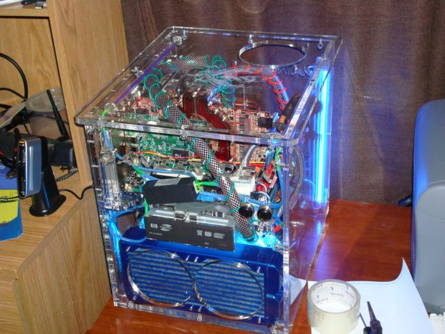

Justintoxicated Posted September 13, 2007 Report Posted September 13, 2007 pic 5 Check this out, if you flip your water block the other way (TDX right?) you can run that long coolant line to the CPU, then out of the CPU into the Video Card, and fromt eh Video card to (whatever the line on your CPU is runnign to). This should shorten up the hoses and and that hard bend to the video card. Quote

dogboystoy Posted September 25, 2007 Author Report Posted September 25, 2007 I was afraid to put to much tension on those light wires, I thought I may break them (fragile), but i didnt need the support anyway with that braided water line. That sharp bend, actually, the way I cut it, supports the V card. I had to trim over and over to get the length right, but it doesnt pull or push that card. The way my coolant flows is: from the radiator to the pump to the res. to the CPU, to the V card, and back to the radiator. So far no leaks, no problems. I hope that lasts for a few months to come, im not ready to open her up again. BIOSHOCK rules, that is a kick ass game and I am so addicted. I have 2 levels left. It is refreshing to see a game with new ideas and I love the mix of new technology with old school theme. I will probably play it again after I beat it,,, I will have to harvest the little girls next time. Halo 3 comes out in a day, so I will hopefully find it at some store once I get around to getting it. I still have not put in my second G card yet, so far I havent needed it yet (all games work great so far), and I do not have the second GPU cooler for it. SO I will put it in another computer and give it to my kid to play HALO 3 when I get it. See ya Brotha Quote
