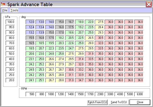

....slow going on the turbo banshee.... still workin' the spark advance map. I had to take the flywheel into work and mill some timing marks on it so I could match the physical timing to what the megasquirt thinks it's at. (like you would to a car)

link is a pic of the spark table (not mine) so you guys can get an idea of what it's like....
