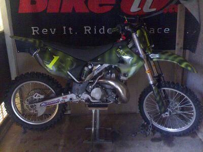

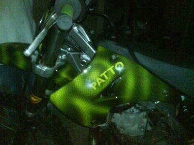

streetshee Posted June 19, 2007 Report Posted June 19, 2007 saw my freinds crosser a few weeks ago and hes done this snakeskin/reptile effect allover,looks real smart,i thought it was airbrushed on but it aint! basicly hes painted a base coat black,then got a few pairs of his favourite fishnet stockings(maybe i should re-phrase that to his wifes favourite!) layed em over the surface pulled nice and snug over the top and taped to the back of the fenders,then put a nice kawa green over the top,fcukin mint!!!! excellent finnish.i try and get some pics of it 4 u. seeyaz... Quote

streetshee Posted June 22, 2007 Author Report Posted June 22, 2007 ok,there not the best pics but here goes..... Quote
ClimbAnyHill Posted June 23, 2007 Report Posted June 23, 2007 I saw that same episode on AC :thumbsup: Inventive! I can kinda see the effect on the plastic but man, some clean shots out in the sun would be cool :cool: Quote
