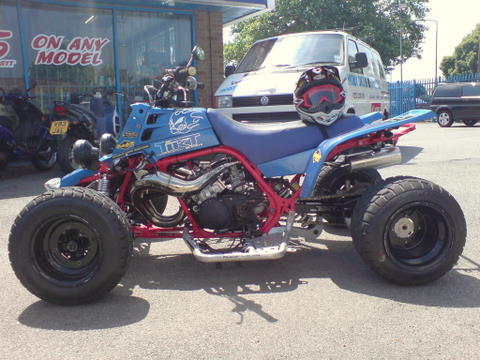

streetshee Posted June 19, 2007 Report Posted June 19, 2007 hiya lads,just wanted to know whos usin -2 swingarms for tt racin,im havin problems gettin off the line with my +2!! (yes i know +2 is useless for tt,but i use her on the street too ) so im gonna shorten my original one,how much better is the hook up with a -2? can someone(s) post apic of there -2 swingers,from the side too please cos i wanna look how much shorter shee is with one,thanks loads,seeyaz Quote

streetshee Posted June 23, 2007 Author Report Posted June 23, 2007 heres a side shot at the moment,cant wait to put -2 in......... Quote
