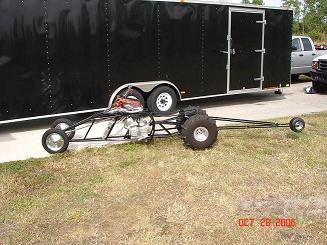

535banshee Posted December 23, 2006 Report Posted December 23, 2006 (edited) my bike with a 78mm bore 18mm stroke twister. 26'' out the front and 11'' out the rear. dont waste your time with stock frame Edited December 24, 2006 by 535banshee 1 Quote
