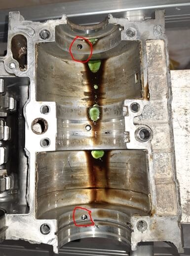

FCapde Posted March 23, 2022 Report Posted March 23, 2022 Hi poeplo. My Banshee have leaks at the lower crankcase like you can see in the viedo. I think those leaks come fron holes on crank bearings housing like I pointed on the pics. Anybody know how I can solve those leaks? Thanks. Quote

FCapde Posted March 24, 2022 Author Report Posted March 24, 2022 11 hours ago, 375hp banshees said: What makes you think that? Because I have a video where I can see the leak to the other oppostie side (outside). I couldn't upload that video. Follow this link to see it. It is like have a plug. Quote

caleb90 Posted March 24, 2022 Report Posted March 24, 2022 Will say what those blind holes are for Quote
375hp banshees Posted March 24, 2022 Report Posted March 24, 2022 Well there not to lube the ground...are they?Sent from my SM-A505U using Tapatalk 1 Quote
375hp banshees Posted March 24, 2022 Report Posted March 24, 2022 Hi poeplo. My Banshee have leaks at the lower crankcase like you can see in the viedo. I think those leaks come fron holes on crank bearings housing like I pointed on the pics. Anybody know how I can solve those leaks? Thanks.Did you pull it apart to fix, or that is a random pic. ?Sent from my SM-A505U using Tapatalk Quote
caleb90 Posted March 24, 2022 Report Posted March 24, 2022 2 minutes ago, 375hp banshees said: Well there not to lube the ground...are they? Sent from my SM-A505U using Tapatalk Those holes are blind. If its leaking some one drilled it out.. Quote
375hp banshees Posted March 24, 2022 Report Posted March 24, 2022 Yeah well his can see ...so now what?Sent from my SM-A505U using Tapatalk Quote
FCapde Posted March 24, 2022 Author Report Posted March 24, 2022 54 minutes ago, 375hp banshees said: Did you pull it apart to fix, or that is a random pic. ? Sent from my SM-A505U using Tapatalk It's a random pic. The engine is running. Quote
FCapde Posted March 24, 2022 Author Report Posted March 24, 2022 53 minutes ago, caleb90 said: Those holes are blind. If its leaking some one drilled it out.. See this... Quote
375hp banshees Posted March 24, 2022 Report Posted March 24, 2022 I would clean it real good. use a tiny amount of silicone or something similar to seal the very End of the hole, to stop it from leaking anymore, let it dry After it's dried good. clean it again, scar up the hole (more horizontally, than vertically) so your epoxy of choice will stick, and use devcon ,JB Weld... if it doesnt work you can re do it & fill it up untill that whole cavity is full if neededSent from my SM-A505U using Tapatalk 2 Quote
