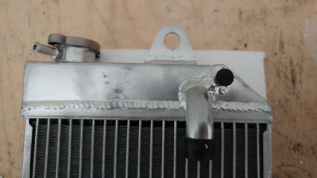

Canadianshee Posted January 26, 2017 Report Posted January 26, 2017 Just received a new oversize rad with silicone hoses from China off of eBay. Seller is winner racing. Rad made it to my door in 9 day, fast for coming from China to Canada. The Rad was was packaged and protected well as there was damage to the box itself, but rad was not damaged. The rad it self seems to be put together well. There are a few spots where the welding is not the greatest, but total cost for rad and full set of silicon hose for 140.00 Canadian, so no complaints here. The cap does look a little cheap will prob try to find a cap with a temp gauge built in to replace with. Sent from my LG-H831 using Tapatalk 1 Quote
RagunCajun Posted January 26, 2017 Report Posted January 26, 2017 I have one on my bike. It was about $55-$60 shipped US dollars. I chose to just run cheap hose from NAPA. Works fine so far. I have a little under 13 hours on the motor. Mounting holes were great and had to be modded. I didnt look at the welds to see how good they are. For how cheap they are, it's just fine. Quote
Canadianshee Posted January 26, 2017 Author Report Posted January 26, 2017 I put it up against the stock rad as frame is out for powder coating. Two of the mounts look spot on but one on the left seems off a bit. Will know for sure when frame gets back. For price I can deal with moding the mount. Agreed compared to price from the Yamaha stealer Quote
RIPPIN' IT UP Posted January 26, 2017 Report Posted January 26, 2017 Got one in use now been there for 4 plus years now without a single problem. Mounts where a little tight to fit, that was about it. Cost a little over 100 Aussie dollars, welds are some of the best I've seen in a while. So I got a spare one from ASI for 90 bucks just in case I put a stick through the first one. Had a few close calls. Sent from my ZTE T84 using Tapatalk Quote

bluebanshee98 Posted January 27, 2017 Report Posted January 27, 2017 (edited) Loosen the side radiator brackets on the frame. move accordingly and put all 3 bolts in. Then tighten down. Some fit a little better then the others but do work Edited January 27, 2017 by bluebanshee98 1 Quote
