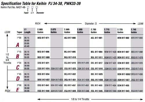

Piediddy Posted June 23, 2014 Report Posted June 23, 2014 Can you lean the needle some? 1 notch at a time. I have a chart on all the different needles I could send u. Quote
shrimp Posted June 25, 2014 Author Report Posted June 25, 2014 Can you lean the needle some? 1 notch at a time. I have a chart on all the different needles I could send u. Sure I could use it. Thanks. [email protected] Quote
