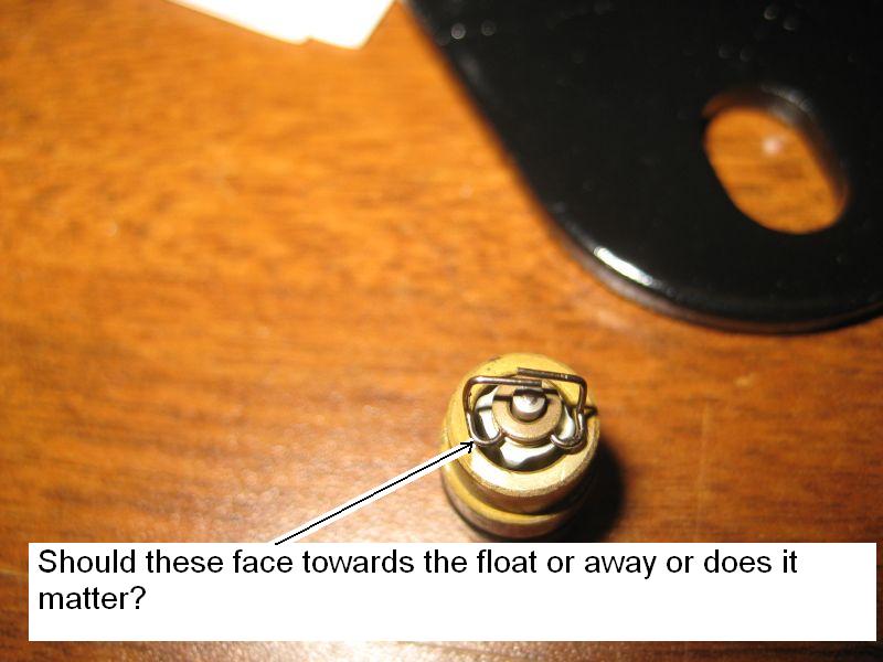

BrokeVW Posted May 22, 2014 Author Report Posted May 22, 2014 Thanks very much, I'll continue on with removing the control unit and wiring then.... I'll leave the needle alone and not worry about the washer, and I'll try to sort out how water is getting into the stator area. Oh, one last question... does it matter how this fuel valve is inserted as far as the thin wire loop used to hang it from the float? Quote
