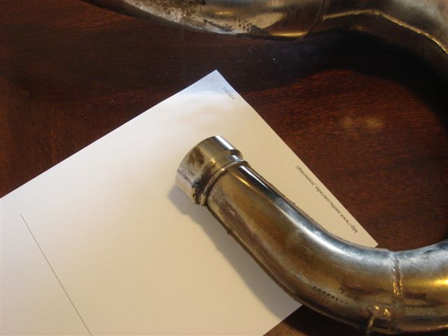

SonOfSand Posted March 26, 2011 Report Posted March 26, 2011 Hey guys, I think these are small bore, just wanted to ask someone that knows. Thanks. Quote
Boston Posted March 26, 2011 Report Posted March 26, 2011 kinda hard to tell from that pic. does the it neck down at all where the flange is welded or just the same diamater? Quote
pabansheematt Posted March 26, 2011 Report Posted March 26, 2011 They look like small bore to me. Quote
SonOfSand Posted March 26, 2011 Author Report Posted March 26, 2011 kinda hard to tell from that pic. does the it neck down at all where the flange is welded or just the same diamater? If I am understanding you correctly, yes. Did you click on the picture to enlarge it? Quote
crazycanuck Posted March 26, 2011 Report Posted March 26, 2011 (edited) Im pretty sure those are small bore. Here is a Picture of Big bores, notice the step in the flange area? Edited March 26, 2011 by crazycanuck Quote

camatv Posted March 27, 2011 Report Posted March 27, 2011 those are small bores the flange to pipe is nearly the same on BB most people think that just cause the pipe dia is BIG makes thema BIG BORE pipe and they are sold that way. small bores will REV and the BB's will make more TQ on the 10's i personally like the added TQ them larger motors dont really like to rev to 13K anyways. Quote

ban565 Posted March 28, 2011 Report Posted March 28, 2011 I believe that the inside diameter of the sm bore is 7/8 in the big bore is one inch . Quote
RadarRacing Posted March 28, 2011 Report Posted March 28, 2011 On the other end of the pipe there is a difference. The smallbores taper down to the stinger before they really curve in towards the middle of the bike, the bigbores curve in towards each other and actually are fat still just under and inside the top frame tube. Mine actually crowd my lectrons but my 4mil likes bigbores. Quote
