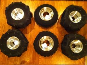

Thank you for the input i returned the sand stars and got these :
Skat-Trac 8 Edges 21x12x8 bead to bead buff (dunner/racer) for the rears
mounted on 8x8 Douglas Blue label 8x8 wheels
Skat-Trac Mohawks 21x7x10 for the fronts with bead to bead buff as well to match rears and mounted on Douglas 10x5 wheels.
I also got another set for the rear : still waiting to receive them this week =)
Skat-Trac 10 blads Extreem 21x12x8 bead to bead buff (dunner/racer) for the rears
a pic of some of the goodies i received so far. stlll waiting on the swing arm, front A-arms, R2 pipes,hubs...etc

ITP makes a 22" sandstar front tire. I used to run them. I've also ran a 22" Kenda dune runner and I would recommend the sandstar over it anyway of the week. That's not to say the dune runner isn't a good tire, but that the sandstar is better.
Figaro, looks like a lot of parts are comin in. You should start a build thread so everybody can see it come together!
