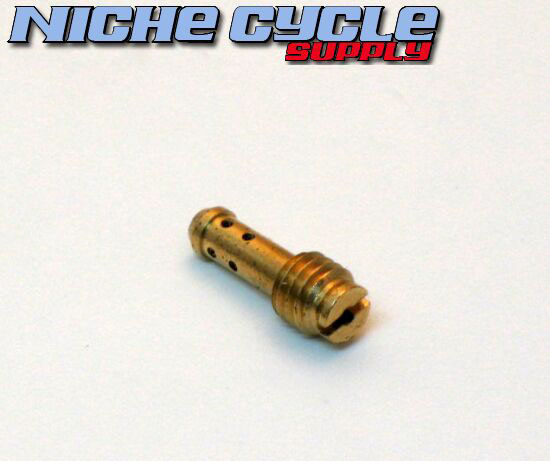

333bbb333 Posted November 30, 2009 Author Report Share Posted November 30, 2009 If you can get me picks of the pilots I should have extra if I have the same type mikunis have three types I still got to get the pilots out but the carb model is Mikuni VM28-418, the pilots should be #15 in there now but I wont get to get to that till tomorrow, I will get some pics. Quote Link to comment Share on other sites More sharing options...
333bbb333 Posted December 2, 2009 Author Report Share Posted December 2, 2009 If you can get me picks of the pilots I should have extra if I have the same type mikunis have three types Here is a pic I found online, it looks like the pilot I have, only I think my pilot has one more thread to it and seems a little closer together but it could be the close up shot that is getting me. Regardless I can not find my cable for my camera so I just used this image since it looks just like mine. My carbs are VM28-418 Quote Link to comment Share on other sites More sharing options...
