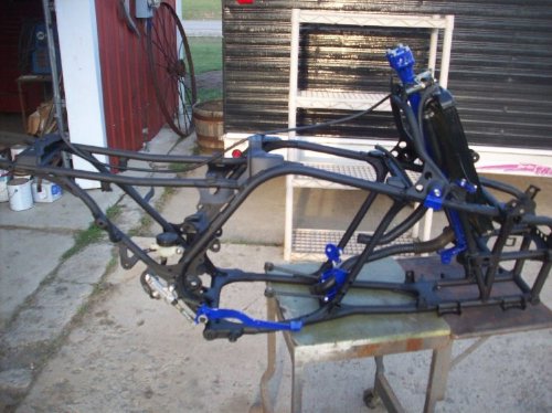

2strokesmoker Posted April 20, 2009 Author Report Posted April 20, 2009 huh no shit. lol. Well now hes tyrin to per sway me into selling my re maned crank and wesico top end to our other buddy with a banshee, and giving me wholesale cost price on a +5mm stroker crank for 420 and the top end kit for 125! I dont understand this guy. First he talks a bunch of garbage and then hes trying to help me out?????? Hes a great guy but I think I would rather beat him with the least amount of mods, but on the other hand a 385 stroker dont sound too bad????? :thumbsup: so here is the start of my ground up build!!!! Wahooooooo!!!! Quote

dragbanshee Posted April 20, 2009 Report Posted April 20, 2009 If you want to be sure, just go ahead and port it and do all your simple inexspensive add ons....+4 timing, Noss head, reeds, good carbs, ect.... You have it apart anyway, do it right!! Quote
2strokesmoker Posted April 20, 2009 Author Report Posted April 20, 2009 If you want to be sure, just go ahead and port it and do all your simple inexspensive add ons....+4 timing, Noss head, reeds, good carbs, ect.... You have it apart anyway, do it right!! I want it to be a reliable trail quad and we also go to silver lake sand dunes like 5 times a year. Any suggestions on what port job would be ok? Carb size? Noss head????? is that a cool head? What size domes? Race gas? Thanks and any help would be great. Want to slap the top end on as soon as i find out what im gonna do!!! Quote
