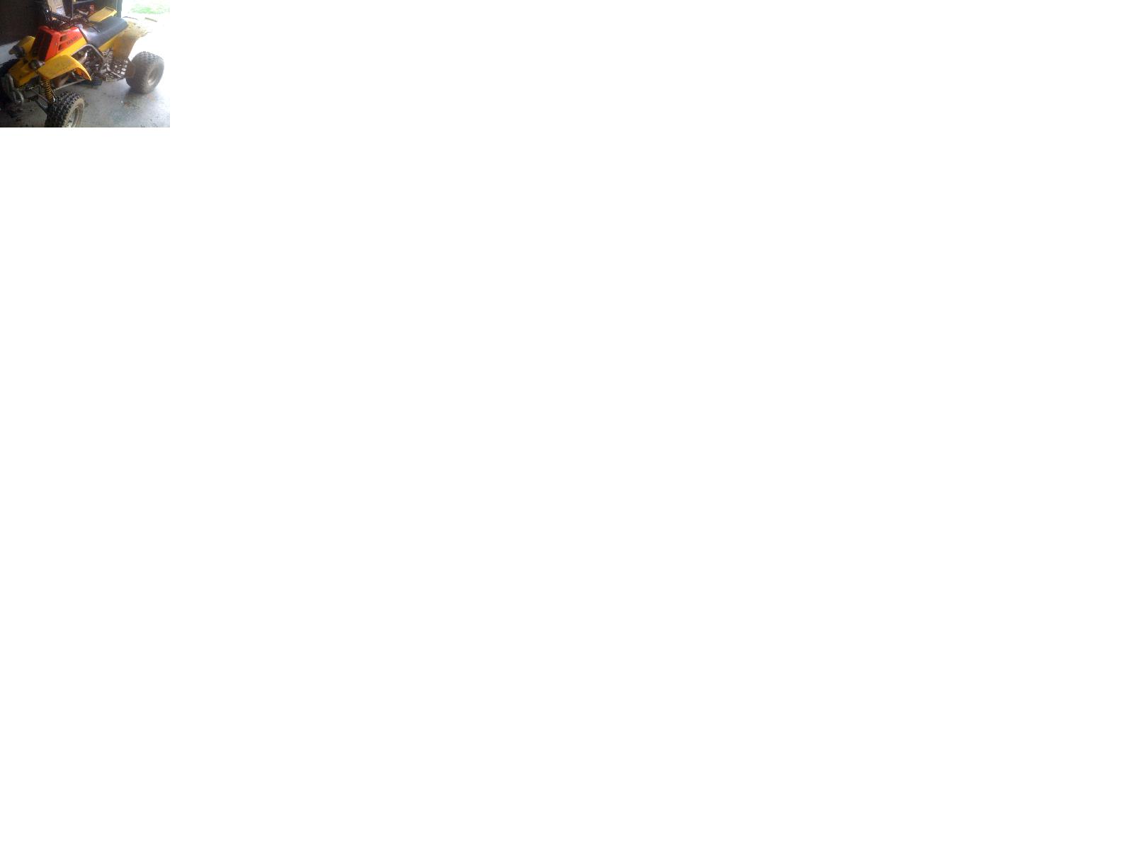

grizzly700 Posted October 31, 2008 Author Report Posted October 31, 2008 ok so i had my dad run out to the barn and get my serial number off the bike cause i keep them at his house but dont live there. he radioed it to dispatch since hes a sheriff and its easier for him to figure stuff like that out. he said if it is stolen no one has reported it so im gonna go for. im headed up there after work to see if i can get it running and to take some pics for my profile. i got fuel line from work so i can replace that since it cracked and ill finish draining the old gas and put in new. i also bought a K&N air filter, charge filter and adapter so i can put that on since the original is missing. suprise suprise. then i have to fix the crab somehow. i just want to start it so i know if the motor is good or not. if it is ill prolly tear it all down and build it over the winter. im prolly gonna eliminate the ignition all together and just put a killswitch so its hot all the time except for when the killswitch is opened. thanks for the help and it will prolly be a couple hours till i post pics cause ill prolly ride the grizz for a min. Quote

grizzly700 Posted October 31, 2008 Author Report Posted October 31, 2008 srry about that pic. i posted clearer pics on my profile if u want to see it. Quote
