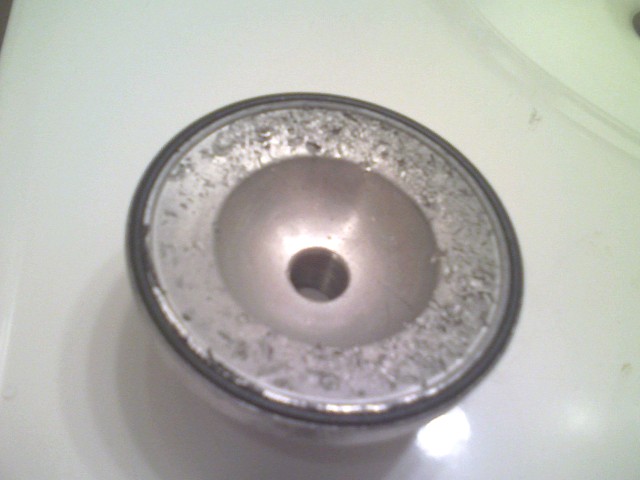

skuddlebug Posted October 16, 2008 Author Report Posted October 16, 2008 I think you pretty much answed my question. I didn't have any spacers. heres a pic of the one that got beat to death. its not a very good pic tho.... Quote
jbooker82 Posted October 16, 2008 Report Posted October 16, 2008 I think you pretty much answed my question. I didn't have any spacers. heres a pic of the one that got beat to death. its not a very good pic tho.... Yea it is beat. Looks like a standard dome will work. There isnt enough material machined out of the domes to be a cut stroker dome. You can still give noss a call. He is a good guy to deal with and BHQ members get 10% off. Quote

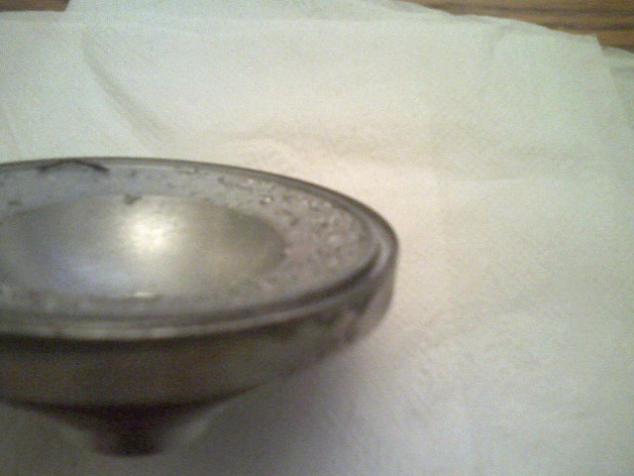

jbooker82 Posted October 16, 2008 Report Posted October 16, 2008 Could you post another pic of the oring grove on the domes. A standard bore dome will have a groove for the o ring to set in. A Big Bore dome will only have part of the groove. The ouside part will be missing. Quote
skuddlebug Posted October 16, 2008 Author Report Posted October 16, 2008 it has a groove for the o-ring to sit in. Quote

Tedder Posted October 16, 2008 Report Posted October 16, 2008 Whoa...Lets back up here. Is that old damage? Whats pictured is exactly what you get when a crank bearing starts to disintegrate. Quote
J-Madd Posted October 16, 2008 Report Posted October 16, 2008 Whoa...Lets back up here. Is that old damage?Whats pictured is exactly what you get when a crank bearing starts to disintegrate. EXACTLY..you need to diagnose what caused this, not just replace the dome. Looks like deto, or metal (i.e. pieces of a bearing) in the cylinder. Quote
J-Madd Posted October 16, 2008 Report Posted October 16, 2008 I might add, if the cylinder wasn't damaged, it has to be deto. Bearings/foreign material would damage the cylinder wall, piston and head. Quote
skuddlebug Posted October 16, 2008 Author Report Posted October 16, 2008 I think its old and just put back on. the piston looked fine other than carbon build-up and there were no scratches on the walls. and the dome itself was rough as you can tell but it didnt have shape edges, it felt like it has been like that for awhile. as for mods...it doesnt appear to be stroked but it has been bored .040 (1mm) over, 29 mm keihin carbs, fmf fatty pipes, boost bottle, new holeshot HD front and back. as far as altitude....who knows. (east TN) cleared trails and open field riding. 91 is about the highest octane pump gas around here, there are a few with 93 tho. Quote
