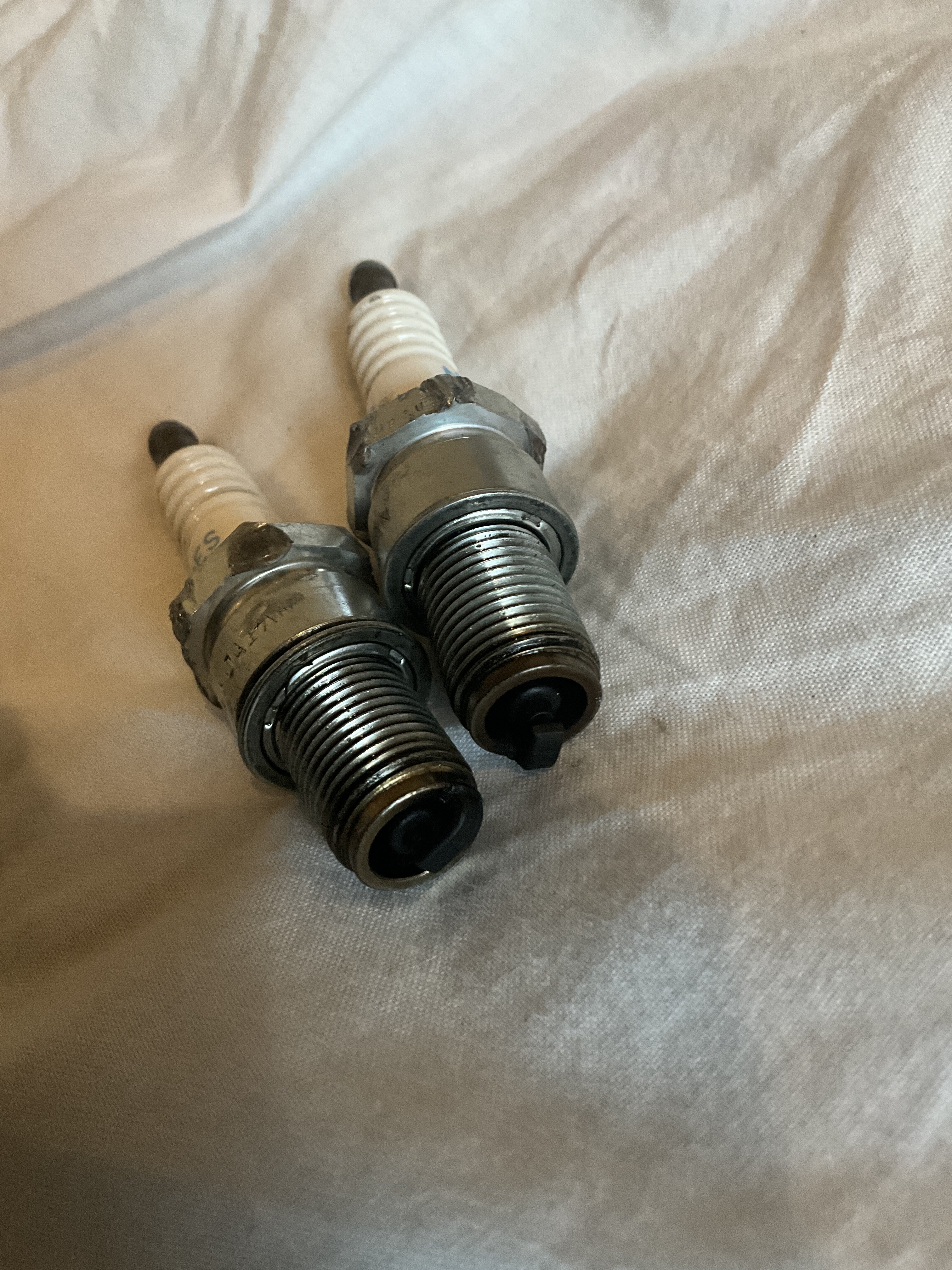

I’m in the Middle East, temp is around 75F atm. I run 28mm pwks with a 155 main and 48 pilot, needle on the middle clip. I fouled a plug, all the time my plugs look black, and I get oil around my pipe so I feel like I’m rich. I run yamalube 40:1. Cos I was rich, I raised the needle clip and it got much worse, very piggy, so I put it back in the middle and it got better, so I think the needle(N68J) is fine. i decided to drop the pilot jet down because the sweet spot was 5.5 turns out on the air screw, but no matter how much I adjusted the air screw on the 45 and 42 pilots, it would run horrible, like it would turn on for 5 seconds and in those 5 seconds there would be loud backfires from the exhaust and no consistency. When I put the 48s back it would run alright for a bit but then it looses all power and bogs, when I turn the fuel off it runs well when I rev high but doesn’t last long, I am so confused -

thanks so much jerz, finally got these plugs out. Look at how rich these things are. I am planning on dropping down the needle clip and the jet size on my 28mm PWKs. whats the best what to get myself roughly perfect on the jet and needle before doing a plug chop? I plan to do a mid range and top range plug chop soon, but i'd like to get pretty close before so i dont have to repeat it. thanks again -
