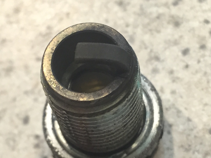

Did a longer run yesterday and now I am thinking rich... Does vp110 mixed with 93 pump make less brown and more grey tint? Plug has grey tint up and down but mix is comming out both exhaust ends? Using 32:1 castor. This is with 160 mains center clip! I think the race fuel is messing me up. Radar might have been correct with his original thought of 155. This chop was warm up and about 5 long straight runs at WOT in 6th. Bike is fast and quick. Needs longer arm. Trying to be safe and get the most out of her. -

In you opinion how do my plugs look? -

I was thinking it was light but that could also be being paranoid beer bottle brown it is the 162 would have worked but for now I am safe with 165. Thanks for all your input RR! I think now I am rich on the needle jjh middle clip, plugs got dark fast in the middle messing around the yard. Runs great though. Better than i imagined

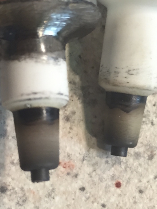

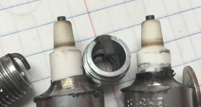

Here is the currant plug chop. Let bike warm up removed plugs, put in new plugs had to ride about 1/4 mile or less slowly them hammer on. Slight incline WOT to 5th held for 10 secs touched 6th then too fast. Let it roll (while off) to a stop then removed plugs and rode home on old ones. Damn this thing runs like a raped ape now. I am very surprised by the servals forgiveness and low end with the shearer pipe. Money well spent. This is with 165 mains -

I did not push it just a few wot then shut down. I have plugs from 170 run today. Have not chopped yet will do tomorrow and post but the tops are dark so I am in that range. I don't think I was as lean as I thought at 162 but deff too lean for comfort. -

162 is too lean. After short open run, plugs are evenly whit/grey. Bike did not get too hot though at least according to my lazer temp gauge. Try bigger jets soon. 170 then down -
