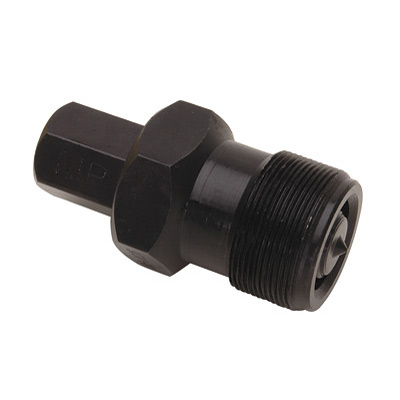

what other speciality tools will i need? some clutch puller?
