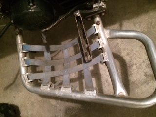

Anybody know where I can find replacement webing for these nerf bars I have? Just bought the banshee with these on it, not sure what the brand is. Can't find 3x3 webbing on eBay or anywhere online if anybody knows where I can get some let me know.
