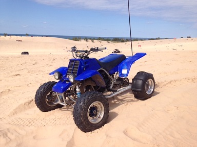

Well its almost that time of year where the top end rebuild will start and I will be stripping the bike to have the frame powdercoated. I cant seem to figure out what color I want, My banshee has blue plastics as you can see from the pic below. I was thinking maybe gunmetal or a little darker and glossier than stock but not sure, I really want to get a custom look. Please post pics of the color scheme you went with under your blue plastics. Thanks!
