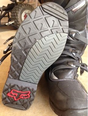

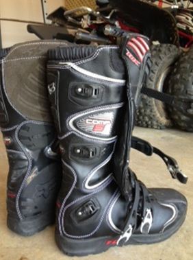

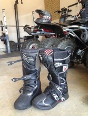

  22. Fox Comp 5 boots, size 13. Retail for $199. Worn three times. $80 + shipping - will consider trades
