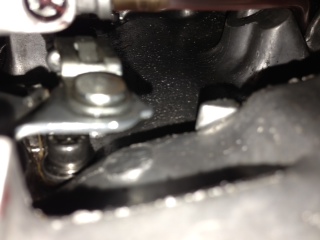

Now this you may be able to make heads or tails of Uman. Does the eccentric shaft look to be OK? I could take better pics? Sorry for playing 21 questions. i really appreciate your help. I'm in way over my head when it comes to wrenching on these things. -

another picture, not sure if you can tell anything from these. One more showing the eccentric bolt to follow -

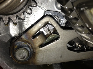

so I got the fluids drained, case removed and tried adjusting on the clutch but now I am stumped. The arrow on the actuator lever is too far to the left side of the bike. Nothing that i do to the to the adjuster bolt located in the center of the clutch basket will line the arrows up. I loosen the cable on the perch by turning it all the way in, i push the actuator arm forward as far as I can (per Yamaha's instructions) and then I adjust the bolt on the clutch until the arrows are aligned on both the actuator arm and the "protuberance", as Yamaha calls it, on the case are aligned. When I am doing this, the adjustment is pushing the actuator arm back towards the left side of the bike until they are aligned but only because I am applying pressure. When I let go of the actuator arm it swings "back" (towards the left foot peg) and the arrow on the arm is no loner aligned. I can start to re-align them when I take the slack back out of the cable by backing it out on the perch but I don't get anywhere near close enough before I am out of adjustment on the perch. It has a practically brand new Toomey racing clutch. I am thinking the cable is too long. It is not the stock cable (it's steel braided). I understand that the two arrows aligning are a general guideline and may not be spot on but I am not even getting close. I can run the bolt on the clutch so far in that i really don't have enough threads for the locking nut and i can run it so far out that the crankcase wouldn't even clear it and neither extreme solves the problem. The goal is to have the arrows aligned without me manipulating the actuator arm, right? Then I fill it back up with fluids and test it out, meaning I should still have plenty of room to fine tune things on the perch in case it needs to be loosened or tightened slightly to hit the sweet spot. Does this sound right or am i missing something altogether. -

Well, I think (hope) the clutch just needs a simple adjustment. Not sure if you can tell from the pic but the "arrows' are nowhere near lined up. Thanks for all the help guys. Wish me luck -
