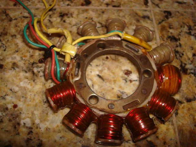

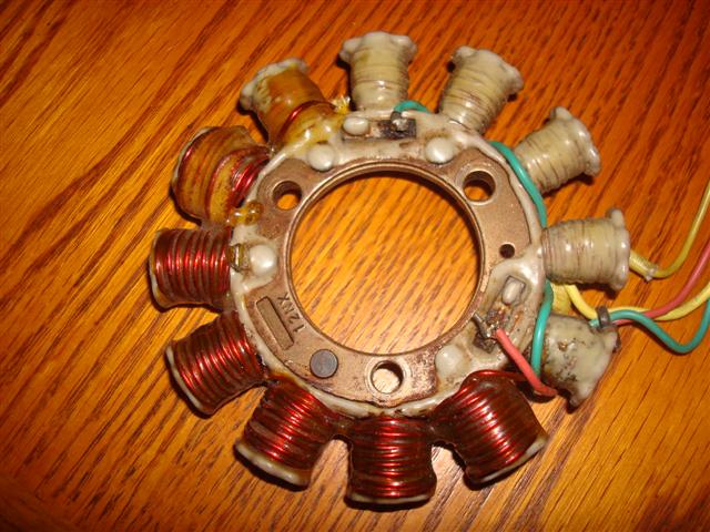

Bansheesandrider, I followed the instructions and removed the epoxy but could not see any wire to solder to. upon close inspection, the stator may have had it done already. if you look at the pics, you will see the red windings, and there are yellow wires attached directly to the windings, 1 at each end. Is that what i am after? Also, I am hopping the red windings indicate a rewound stator for higher output. Thanks for your input. Rick

Thanks Bansheesandrider, So where does the new wire go to from the stator? Does the rectifier replace the voltage regulator? Rick
Is there a kit available or a part # regulator/rectifier (I assume that is different than the voltage regulator I just bought because mine was missing) Is the ground on the lighting side or the ignition side of the stater, and when you say "float the ground", what does that mean? Thanks Bansheesandrider Rick
