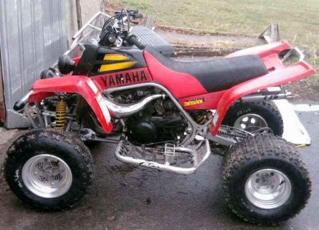

  16. ok so i did a compression test, i hooked up one cyl at a time leaving the other spark plug in and on a single kick i get 40PSI on both. maybe a 2psi difference between the 2 but im only seeing 40PSI, what gives? bike starts and runs amazing, 2 kicks after sitting the past 3 days in 40*F weather. am i taking the test wrong?

  19. first banshee ive owned so i know very little about them but i picked up a decent 1995 with unknown mods other then toomey t5's. i would like to check it all over but dont know the common issues, things to keep a check on and what to spot for mods that have been done. can anyone point me into the right direction for a basic going over? so far i have rode the bike 3 times and all seems good to me but i notice some clatter or pinging on the right cylinder, seems to come in when im up to operating temps but isnt real loud. both pipes have even amount of exhaust flow. ive rebuilt a few 4 strokers in my time but like i said this is my first 2 stroke and i dont really know much about them
