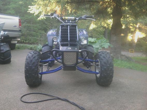

  1. heres some pics of the fronts on my banshee and raptor that i sanded and torched. plastics are a little dirty at the moment and the pics are with my phone.
  2. i marked it with tape and used a dremmel multi tool, the first time i used a hack saw blade. then i sanded down the edges, then took a propane torch and went over the sanded edge to make it look factory.

  8. i used all raptor 700 stuff including shocks, aluminum spindles/hubs and brakes. the arms are the same as a yfz, but the shocks are longer. i dont seem to have the camber problem everyone is talking about, is everyone using banshee spindles with yfz arms? that might be a problem? all i can say is my setup is night and day compared to stock, it handles much better, rides better and a huge improvement on the brakes. although i really like the setup, i had all of the suspension sitting in my shop when i got the banshee and if i didnt already have it all i probably would have just bought aftermarket. so unless you can get the entire raptor/yfz setup (arms, spindles ect.) for a really good deal i would just go aftermarket.

  10. all the parts that i used i already had, so my swap was free. i now have aluminum spindles, dual piston calipers and it rides smoother and more stable. i agree arms made for it are probably better and if i didnt have the parts already i would have looked at aftermarket arms/shocks for it, but imo this setup is better than stock shocks w/ aftermarket arms.
