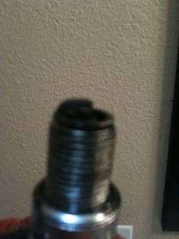

so your saying you think i was only running one piston on idle?.... due to the plug cap. hmm..... do i just replace the caps if there bad? i am aware i need new o rings, the shop that installed the crank seals was supose to do that as well, its on my receipt. bastards. i will be doing a pressure probably this week. i also had another question. my carbs are in sync i think but i have to adjust the throttle cable to get the bike to idle. the slides look a little lifted because of this.the idle screws on the carbs do nothing at all. is this normal or should my slides be complettly down. its weird because the bike used to idle fine when i had the 180 mains with the 50 pilots, however it did have a twist throttle on it before. oh ya and by the color of the plug in the pic do you think im lean or rich??
ok i put in the 145 mains and 40 pilots. big diffrence, seems a little hesitant at first but finally hits the power band im think its a little lean now though, as i said the guy told me it had 36mm but it has 33's on it. im thinking of going to 42 or 45 pilot and 150 or 155 main. i tryed the 40 pilot with the 162 and didnt work at all. still sluggish. i did notice a funny noise though when i ran the 40 pilot and 145 mains. i checked my pluggs and the were black. i took the pic on my iphone so not sure how the quality will come out. i also posted the a youtube video so you guys can tell me what you think that noise is. thanks
