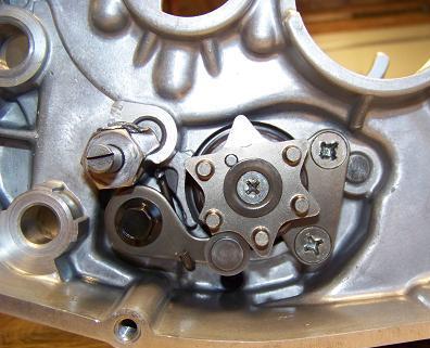

  22. The star

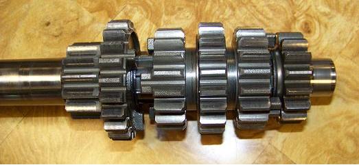

  23. I didn't post any pics of the other shaft because it didn't look to have any alterations. Here is the other shaft. Also the star.
  24. I've got alot of pictures John but it appeared I was the only one posting here. I've since called Twister, really nice folks and asked for some info on the crank. The numbers in the first pic say that it's a 14mil stroke, and has Hotrods 125mm rods. The last set of numbers are the total number of cranks produced which from this they can tell you who they sold it to and when. Turns out this crank was built in '06 and was rebuilt in '08. The size of the stroke explains the welds on the crankcase. Now that I have the crank figured out I still would like some input on the transmission. I can see that three of the gears have been cut for what I assume to be an override. How can you tell if it's a duneable override and which gears are overridden? Also in the pics you can see that the drum has been regrooved. Whats the story here? Thanks for telling me the pattern might be changed, I'll put the trans back in the case and see what I can find out. Is there anything else in these pics that someone can tell me that maybe I have missed? I'll post some more pics tommorrow.
  25. Nothing? Sure could use some help.
