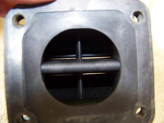

  9. So it's like the inner petals are super low or even zero tension, and the outer petals open with RPM?
  10. Two parts to my question guys. I currently have boyensen rad valves in my bike, I came across some VFORCE3 reeds cheap but when you hold them up to the light you can see through them, is this normal? Second, is this a good reed choice for my bike? This bike has a cool head, advanced 4*, LRD pipes, and no port work. Thanks
