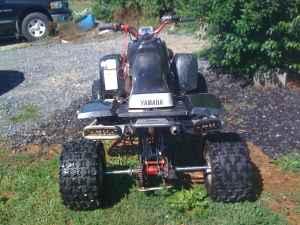

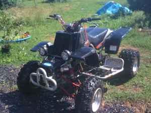

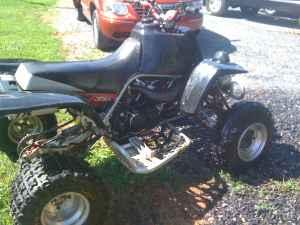

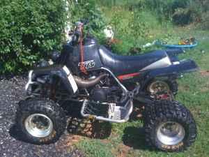

  1. 2003 Yamaha Banshee with tons of extras: Toomey T5 pipes with their perfect jetting Pro-Design Cool Head with 21 cc domes for pump gas Boyesen pro series reeds and spacers K&N powerlid G-force extended axle YFZ450 front suspension with LTR450 shocks, comp. and rebound adj. oversize 5.6 gal. Baja fuel tank Trail Tech vapor computor Adjustable stator plate UM full size nerf bars Teather switch high flow water pump impeller Was re-rung, new clutch, new rear and swingarm bearings, cool head, impeller, reeds and spacers all installed last summer or since then. I have most all stock parts that I will include with the sale. I really like it, runs like crazy, but thinking a utility would suit me better right now with the kids so I'm reluctantly selling. Pics coming soon. Just to be clear, I am in no rush to sell, so no stupid offers. Located near Gettysburg, PA.
