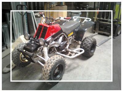

  1. lol okay sorry didnt like english much! I was out riding today for about an hour and when we decided to go eat we headed to the bar on the road i was haulin ass hit 6th and ran for approx 1000yrds 7 to 10 second of almost wide open throttle and when i let up on the throttle the rear end locked up and started sliding, so i pulled the clutch in and coasted to a stop and looked it over and then kicked it over and it started up rode back to the truck which was about a half hour and it was still pullin just didnt stay on the throttle hard in 6th and she was good i was thinkng maybe going to 350 main jets?
  2. the banshee locked up in 6th today when i was out riding i pulled the clutch in rolled to a stop looked at everything thought i toasted her and i kick her over and she fired right up any idea what it could possible made me lock up in 6th almost wide open? i have 320 main jets with t5 pipes, vforce reeds and bored .20 over stock any ideas?
  3. got the banshee back today he put the needles at the lowest setting and ran the 320 main jets it is running great thanks guys
