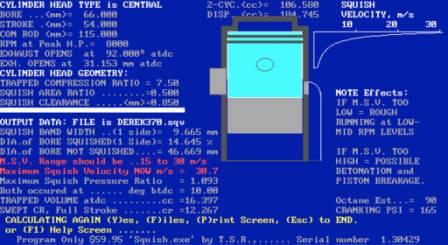

The ultimate showdown cool head vs shaved stock head
SLORYDER replied to SLORYDER's topic in General Banshee Discussion
I can assure you Rick wouldn't put something together if it were going to be less than reliable. This file is for a 370 long rod banshee engine. He has an awesome build for bottom/mid on the banshee and sells the papers for $15. -
Rick just stated that reducing the squish to .035" is a great idea for adding performance using the stock banshee head. I have always said this was safe as well, however I believed race fuel was necessary when cutting this much. I was wrong and I admit it. But if someone would have taken my advice and used race fuel the worst thing that would have happened was wasting some money on fuel. No damage. He recommends milling and rechambering when more than pump gas is to be run. Bottom line we were both wrom=ng. You stated that dropping the squish down to .035" was unsafe and you would destroy your engine. That is false. So please hop your ass off the little flamer bandwagon Daj. I expected more than that from you. -
