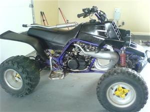

  8. I posted before about a j arm banshee i bought for 1,000. I checked all the fluids and gave it a good lube and decided it was time to put it to use at Haspin. Within 5 minutes the chain broke......New X-ring chain 80 bucks. Then the plugs fouled. Then a coolant line blew. All of which were things I fixed on the spot. The deal breaker was again losing spark on the Banshee after a complete electrical system replacement. As I was getting ready to load up and drive three hours home a Banshee HQ member Rollinrhino told me it sounded like my fly wheel keeper was off. How he could tell I didnt know but he talked me through taking the flywheel off and installing a new keeper. After the new keeper was on it ran better than it ever has. Thanks to Rhino I got another 4 hours of riding in that day. The Banshee didnt give me any more trouble even after taking it on some very nasty trails........Thanks Banshee HQ

  12. I posted before about my Banshee not getting spark. After replacing the wiring harness, coil, and CDI I decided to replace the coil. When my buddy was pulling the flywheel cover out comes the flywheel. Looks like no damage was done. I feel pretty dumb........................

  15. A couple weeks ago my banshee crapped out deep on a trail at haspin acres in indiana. While I was being towed back I popped it in gear and it fired right up. It sounded bad, and missed out unless you gave it alot of gas. After checking this out there is no spark when you kick start it. I replaced the coil and CDI but still no spark. The stator passes a continuity and resistance test so I didnt think that that could be it? The kill switch and key switch were also disabled and still no spark. The TORS have been removed as well. Anyone really good the the electrical on these things? I dont know where to turn. There are not really any professional shops around here.

  22. I have a 89 Banshee. While riding last week it bogged way down and died. It was unable to be kick started. I check for spark there was none. While I was being towed I popped it into gear and it fired right up. It seemed to run fine. I was even able to kick start immeditlely after shutting it off. I shut it off and tried to kick start it two minutes later and....nothing no spark. My coil was already pretty beat up so it was replaced. The stator gave a good resitance test. Could it be my CDI? Or even stator? Could it be a bad ground? Where is the main ground on a 89 Banshee?
