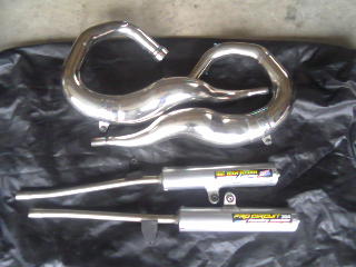

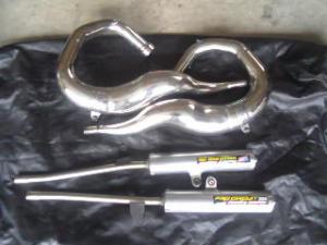

WHAT WE HAVE HERE IS A NICE SET OF PRO CIRCUIT PIPES, NOT PERFECT BUT IN GOOD SHAPE. 200.00 SHIPPED TO THE LOWER 48. AND ALSO 1 BANSHEE CRANK THAT CAME OUT OF A RUNNING MOTOR IT APPEARS TO BE IN GOOD WORKING ORDER. 100.00 .
