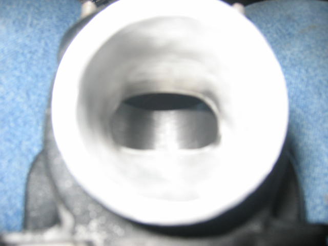

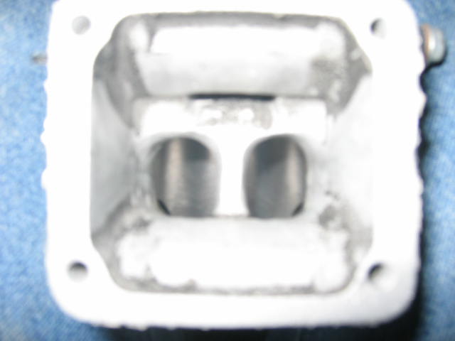

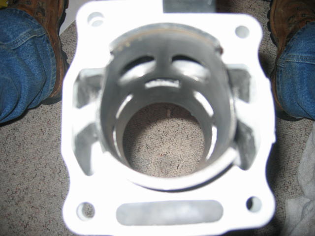

  10. He ended up opening the intake 15%, the transfers 13- 15% and the exhaust 18%. Hopefully it runs good..
  11. I talked to the guy this morning and and he assured me that it was a stage 1 port. He opened up the transfers, intake, and exhaust. You can see inside the cylinder that they were opened up. Overall I received the port job, boreing the cylinders, wiseco pro lite pistons, top end gasket kit, and lightened flywheel for $505. So I took a guess on the $200 for the port work. Hopefully the port is what he says it is. Good thing I have a friend that has about the some setup as me, so I will be able to tell once we hit the sand. I must say that the banshee is worse than a crack addiction, my wife is getting pissed at me. I just tell her she had been replaced by a shee that dont talk back.
  12. It has 30mm oko carbs, Toomey T-4's, shaved head, Wiseco pistons (20 over), Boyesen dual stage reeds, and that is about all I can think of for engine mods. I paid $200 for the porting. I have the motor put back together now, so I cant measure the ports. We will see how it goes when I take it out this weekend. I will keep you posted. Thanks
  13. It just seems that there was not a whole lot of porting done. Being this is the only motor I have ever torn apart, there is much to learn. I must say that this bike is like a crack addiction. When I get her up and going I will let you know. Thanks and I am sure I will have many more questions.
  14. This is my first quad so I am unsure of some things. I was told it was a stage one port which is comparable to a mild dune port, so I have been told. By the looks of the port job, I could have grabbed a dremmel and done it myself. How much is it for a a cleanup port??
