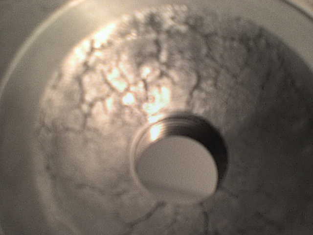

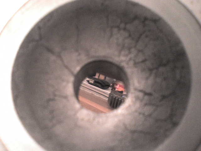

  14. I twisted steel wool in the dome and what appeared to be cracks was gone. But it does look like i have very small pits in it tho. What causes the pits? I have seen pics where domes have pit really bad.
  15. that lip you see it machined so the piston wont hit.
  16. another shot of it
  17. the head or piston dont have any marks of them hitting each other.I dont know if its the casting imperfections with carbon in the cracks to make it visable, or if it the aluminum flaking. But you can feel it. It feel rough when running finger across it.
  18. nothing is bent or broke but i found the dome looks like its flaking :shrug:
