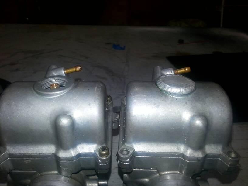

  8. Po had carb welded to clear clutch..I used brass punch and hammer on the inside of welded piece to make a sump instead of being flat. That issue aside.. bore size is 64.75 exaust is 25.50 and transfers are 42.00, compression still 140 on the kicker. Guess I will pull the head and jugs off and report back lesson of the day is take others word with a grain of salt

  12. would one of the plugs on the carb being welded cause any fuel pickup issues?
